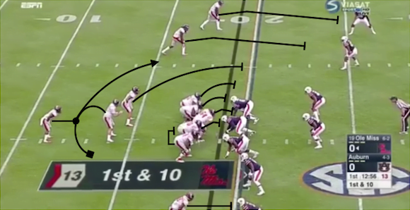

Here’s how the Rebels run the split zone out of their 21 personnel (two backs, one tight end, two wide receivers).

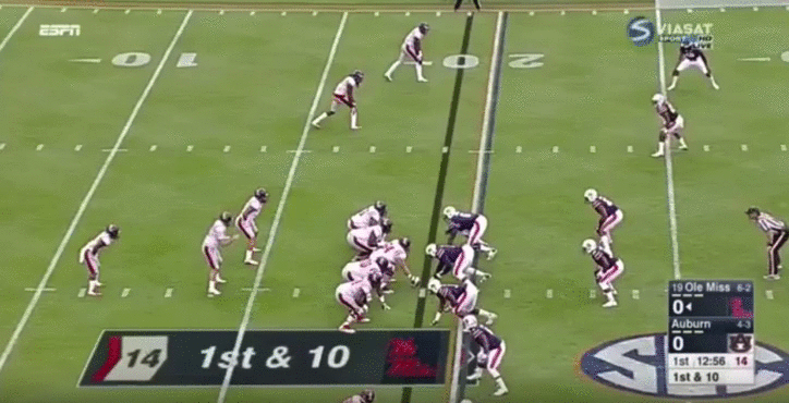

As you can see, the play-side fullback blocks down on the end man on the line of scrimmage (EMLOS) to seal the back side of the play.
The slice is not only effective, but can be complemented with a waggle or bootleg. In it, the fullback bluffs the seal block and releases out into the flat; it gives the quarterback a hi-lo read between the flat man and the breaking receiver.

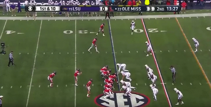

The lead zone is also an effective downhill run play. In it, the lineman block inside zone with the fullback leading through the point of attack to block the play-side linebacker.
The Rebels predominately use the lead zone in 20 personnel. Just like the split zone, they use a play action pass with an identical action to keep the defense off-balanced.
While the lead zone isn’t as flexible as the split zone when it comes to point of attack, it’s a good inside run play for a team with a good blocking fullback.

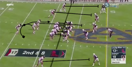

We already analyzed the stretch play in a previous Chalk Talk but not from a two-back formation. Ole Miss uses the stretch in 20 personnel.
In the two-back outside zone, the fullback plays the role of searcher, blocking whomever is the first threat on the outside. If the defensive line is already shaded to the play-side, the fullback can double team the EMLOS and climb to the linebacker or cut him off the line. In the example below, there isn’t a threat on the line of scrimmage so he can immediately go to the first second-level threat.
